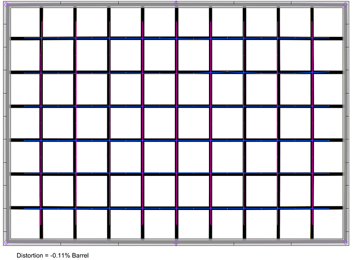

The Nikkor P.C. 105mm f/2.5 is, of course, a fully corrected lens that produces only a marginal degree of barrel distortion.

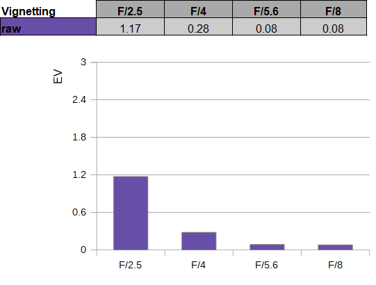

Vignetting is quite well-controlled with a maximum light falloff of 1.2EV (f-stops) at f/2.5. Stopping down to f/4 reduces the issue to a negligible degree already.

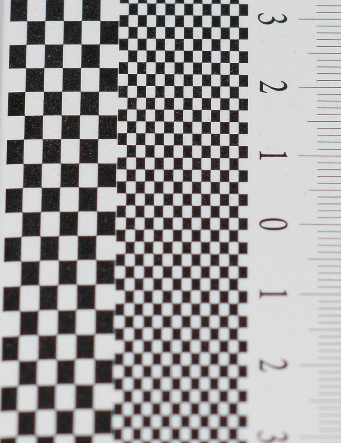

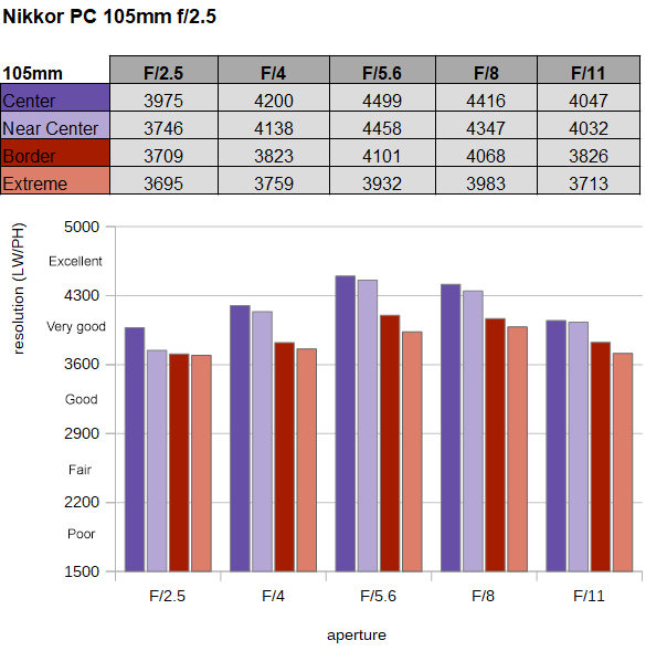

MTF (resolution @ 42mp on Sony Full Format)
As mentioned before the Nikkor has a bit of legendary status and the resolution characteristic confirms this. Even by today's standards, the lens is impressively sharp across the frame. At f/2.5 and f/4 the results are very good and between f/5.6 and f/8 the center even reaches excellent spheres. f/11 remains perfectly sharp but stopping down further should generally be avoided due to diffraction.
The field curvature is low. The centering quality of the tested sample was good.

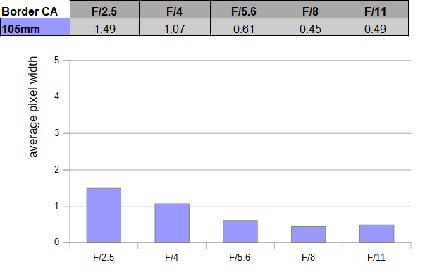

Lateral CAs vary along the aperture range with a maximum pixel width of 1.5px at the image borders at f/2.5. This decreases to less than 0.5px at medium aperture settings.

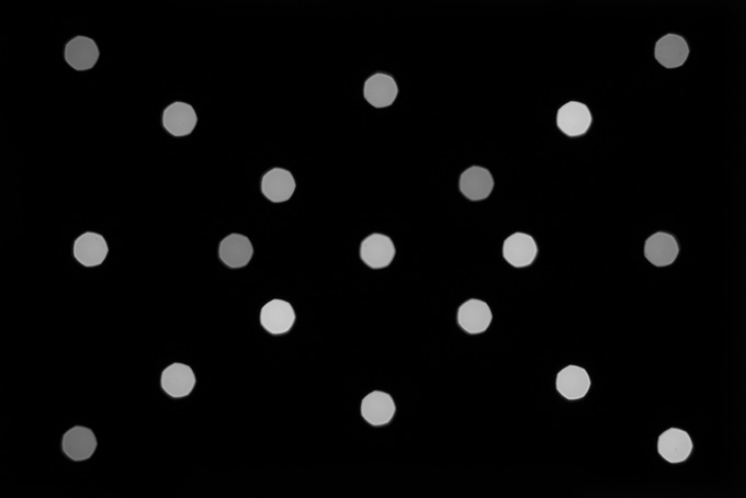

Back in the day, the Nikkor is often described as the perfect portrait lens and we can see why this is the case - the bokeh is very good indeed.

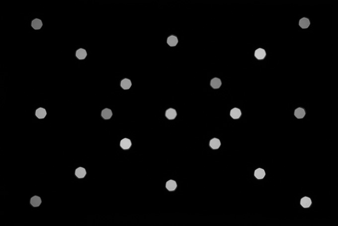

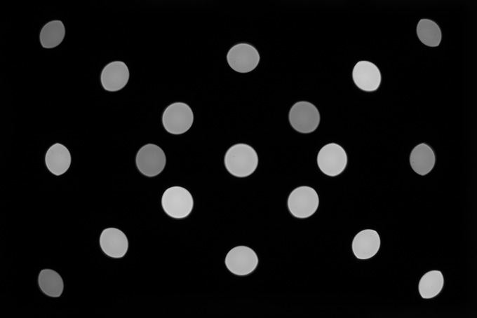

Out-of-focus highlights are beautifully rendered with a smooth inner zone and no outlining. Typical for lenses of this time period, the more edgy aperture shape is already showing up at f/4. At the time, rounded aperture blades, which could mitigate the issue to some degree, were not invented/used yet.
When looking at the whole image field, the highlight discs don't stay circular outside of the image center. The "cat eye" effect is slightly more pronounced in the edges of the frame compared to the Asahi-Pentax 105mm f/2.8 & Olympus 100mm f/2.8. However, the deterioration is still moderate. Stopping down to f/4 restores the "circular" shape at the expense of the edgier disc rendering.

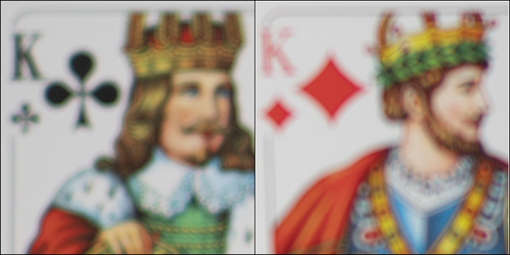

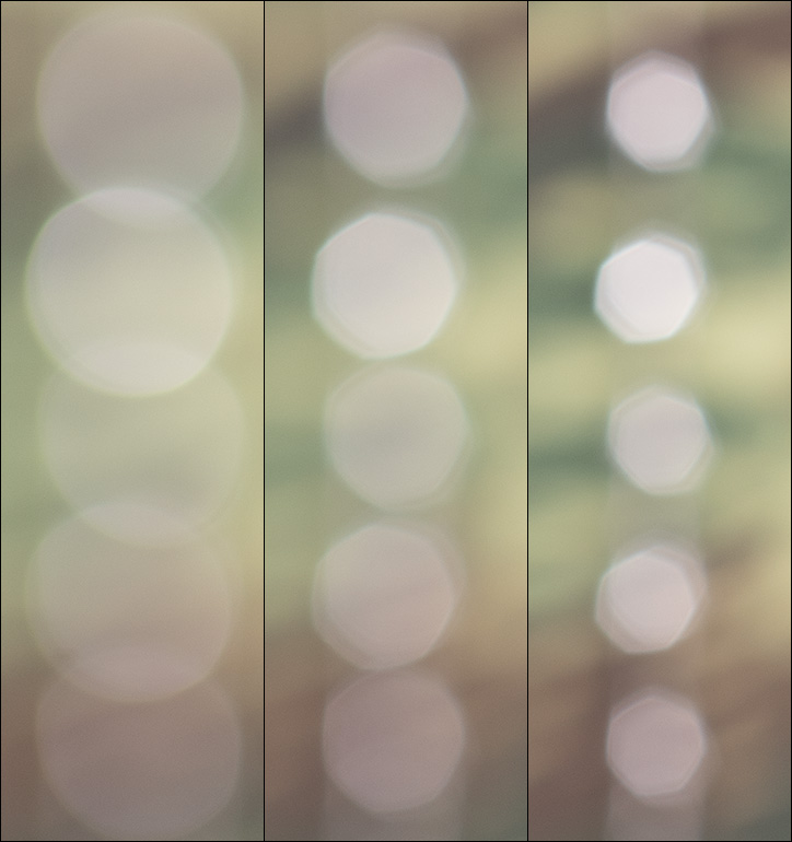

The quality of the general blur in the focus transition zone is exceptionally smooth in the background (shown to the left below). The foreground blur (to the right) is less ideal with double edges though.
Bokeh Fringing / LoCA
The Nikkor doesn't use an APO design, of course, so the fringing is very pronounced at f/2.5. The LoCAs are substantially reduced at f/4 and mostly gone from f/5.6.
