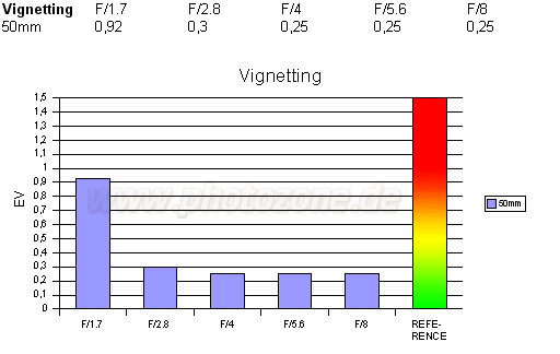

The AF 50mm f/1.7 is a full-frame lens so it can take advantage of a sweet spot effect
on the Alpha 100. However, at wide-open aperture the vignetting is still quite pronounced
at ~0.9EV but it is negligible from f/2.8 onwards.

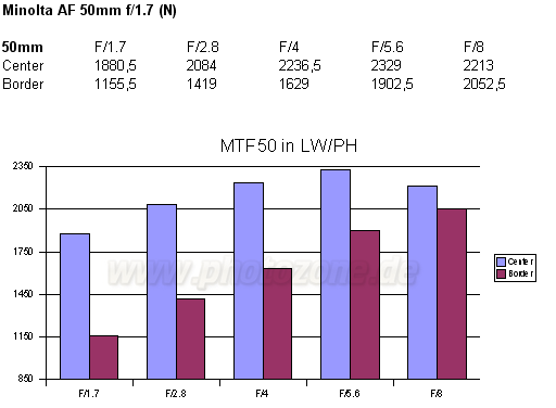

not among the best normal lenses tested to date. The center performance is already
very good at wide-open aperture and stopping down lifts the quality to levels at
or possibly even beyond the sensor resolution of the Sony Alpha 100. However, the
borders are a different story - at f/1.7 they're downright soft and not much better
by f/2.8. It takes f/5.6 to reach very good territories and the peak performance
is not reach prior of f/8 here. The Canon or Nikon counterparts show a much better
border characteristic.
Below is a simplified summary of the formal findings. The chart shows in line widths
The chart is limited to the visually relevant LW/PH range of [850, 2350].
