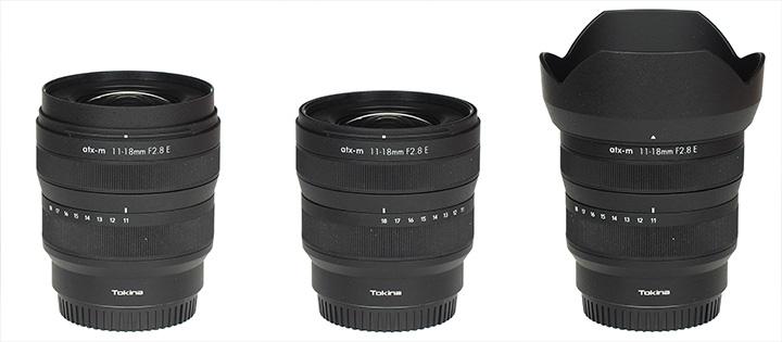

Tokina lenses have a long history of providing high build quality and this also applies to the atx-m 11-18mm f/2.8 E. It isn't obvious whether Tokina used lightweight metal or some kind of compound material for the lens body but it surely feels sturdy. The focus and zoom control rings operate smoothly. The lens extends marginally when zooming to 11mm. However, it does feature an inner focusing system. Thus, the length doesn't change during focusing. Tokina doesn't claim to have incorporated any weather sealing. A petal-shaped lens hood is provided.

The Tokina lens follows the brand's long tradition of having a very good build quality. The lens is lightweight yet doesn't sacrifice a solid feel. The control rings are very smooth. The inner lens tube extends slightly when zooming towards the wide-end - there is nothing wrong with this, but it is a little unusual in this respect. The AF is reasonably fast and it's perfectly silent. While it won't affect most users, we'd prefer finer steps of the AF motor though. As is, manual focusing via the focus-by-wire system feels somewhat coarse.
