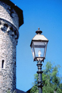

In every photo there'll be a range around the chosen focus distance that appears to be sharp. This range is called the "Depth-of-Field". The following slide show demonstrates the effect of different aperture settings regarding the depth-of-field within a scene. The lamp is the point of focus here. Select one of the shown aperture settings and observe the effect on the background (the castle) - requires Javascript.
