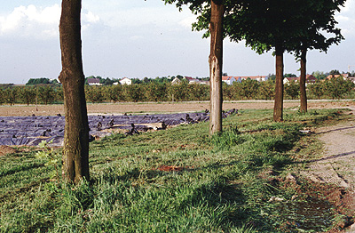

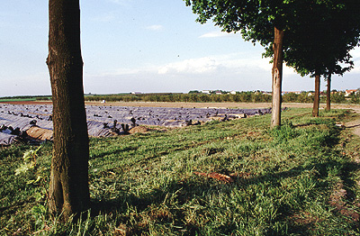

Let's have a look at a relatively wide
focal length first: 28mm. The following image samples show 4 trees with
an equal distance between neighbor trees. At the wide setting it seems
that this distance actually increases dramatically towards the foreground
(exponential behavior of the distance). It other words: the tree to the
left seems to be totally separated from the rest of the gang. The background
seems to be far in the distance.

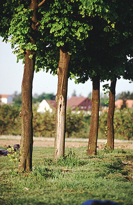

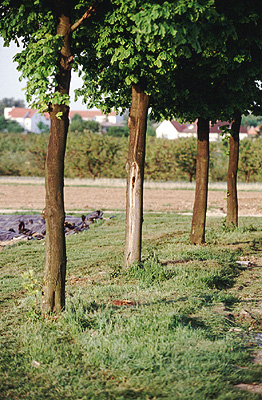

The next picture has a more natural view
at about 50mm. The perspective is obviously much less extreme. Due to our
real life experience we can guess that the distance between the trees is
roughly the same though the separation is still visible (d^2 behavior).
Now we have a 100mm lens. The trees seem
to group here with a seemingly small distance between the trees. Compared
to the previous sample the now enlarged background suddenly moved towards
the main object. The scene is compressed now.
