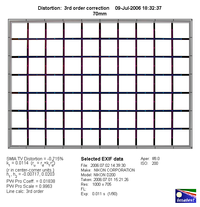

 DistortionThe AF-S 70-200mm VR has a very moderate 3x zoom ratio and the level of
distortion is quite low accordingly. At 70mm there's a moderate degree
of barrel distortion (0.7%) changing to moderate pincushion distortion
(0.7%) at the long end of the zoom range.
             		 	| Move the mouse cursor over the focal length text marks below to observe the respective distortion |
              		| 70mm | 135mm | 200mm |  |

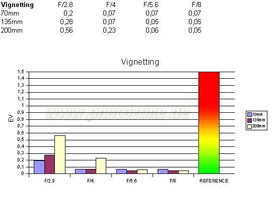

 VignettingOn an APS-C DSLR the full-frame AF-S 70-200mm VR can take advantage of a sweet spot effect.
At 70mm and 135mm the issue is negligible even at f/2.8. At 200mm at f/2.8 vignetting
is a little more pronounced but still not overly field relevant. If needed stopping
down a little will solve the problem completely.

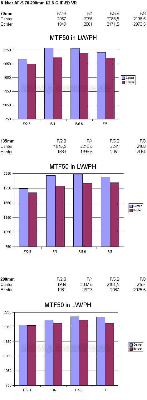

 MTF (resolution)In the MTF lab the first sample lens delivered good to very good resolution figures but
suffered from a rather pronounced centering defect - this is actually not overly unusual
for Nikon VR lenses if the local testing history serves as a guidance. In the meanwhile
a 2nd sample has been tested that performed significantly better - these results are
presented below.
Generally the both the center and border resolution is excellent throughout the
tested focal-length and aperture range.
At 70mm the results are stellar and about as good as it gets on the Nikon D200.
At 135mm and 200mm there´s a marginal decrease in quality which shouldn´t be
really field relevant. The sweet spot of the lens is located around f/5.6.

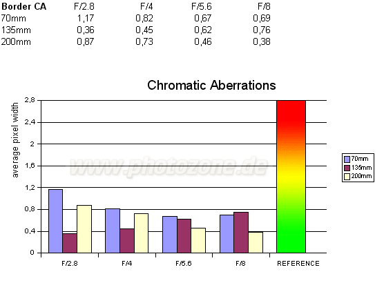

 Chromatic Aberrations (CAs)Chromatic aberrations (color shadows at harsh contrast transitions) are
generally well controlled with a local peak of 1.2px on the average at
the image borders at 70mm f/2.8.
