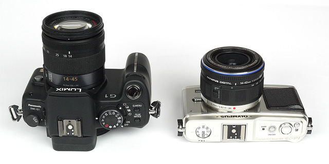

Here's a comparison to its nearest competitor - the Panasonic 14-45mm f/3.5-5.6 OIS:
M.Zuiko in transport position M.Zuiko in working mode (14mm)
