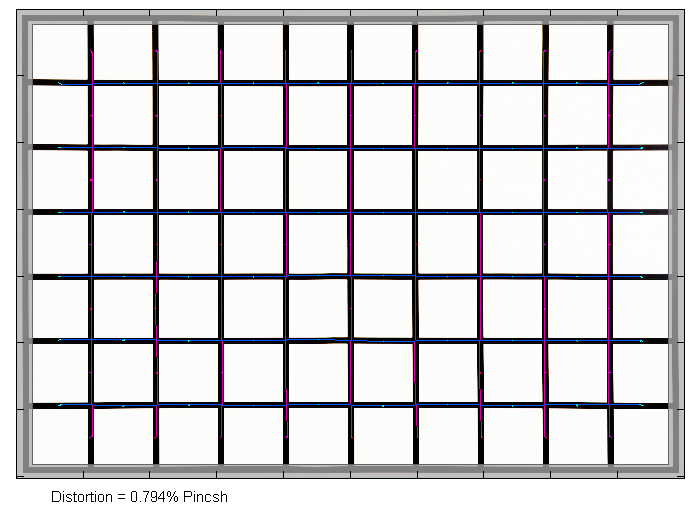

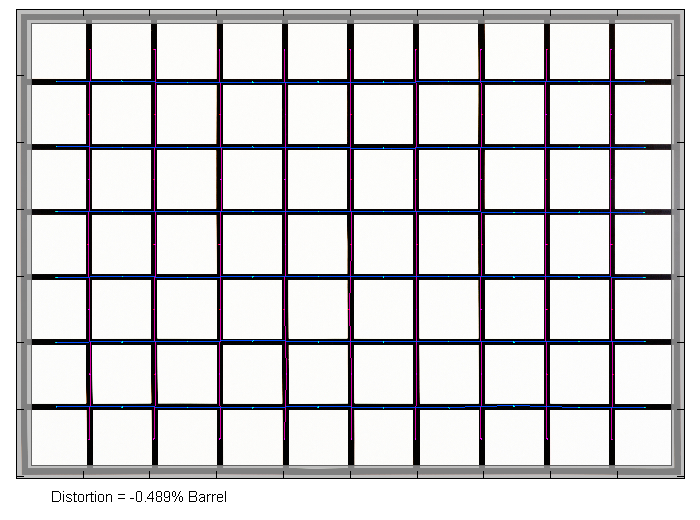

The lens produces a small amount of pincushion distortion of around 0.8%. The Nikon Z system optionally applies software correction, which in this case over-corrects distortion to around 0.5% barrel distortion.
Surprisingly, both amounts are higher than what the Nikkor AF-S 85mm f/1.8 showed.

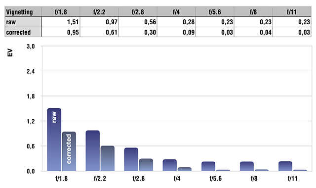

Nikon offers in-camera correction for vignetting, but the situation is a bit more complicated than distortion correction, where it is basically just an on/off setting. Vignetting correction can be set to either 'off', 'low', 'normal' or 'high' in the camera menu, where the default setting is 'normal'. For JPGs, the chosen setting is applied to the final image. If you shoot RAW, the selected setting is stored in the meta data to be applied later by the processing software. In addition, Nikon embeds the full lens correction profile into the NEF files.
Surprisingly, none of the in-camera correction settings Nikon offers makes full use of the correction profile in the same way. Even at the 'high' setting, vignetting is not fully corrected. You can, however, achieve full vignetting correction by using a RAW converter that supports the embedded NEF profile.
For our vignetting analysis of Z lenses, we do not use JPGs generated by the camera, as we usually do for other systems. Instead, we base the analysis on NEF files imported into CaptureOne, with vignetting correction applied to a level that resembles the 'normal' setting of the in-camera correction.
Without any correction applied, the lens vignettes visibly wide open, the amount of light fall-off is around 1.5 stops at f/1.8, reducing to lower numbers by stopping down. From f/4 onwards, it should no longer be visible with most subjects.
With "normal" correction applied, the images still show almost one stop of vignetting wide open. Really low figures are achieved at f/2.8 already.

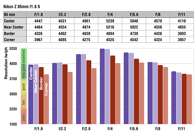

The Nikkor shows very good resolution across the whole frame at the maximum aperture. Stopping down increases resolution further, reaching excellent numbers across the whole frame at f/4 and f/5.6.
The lens showed some focus shifting when stopping down (residual spherical aberration).

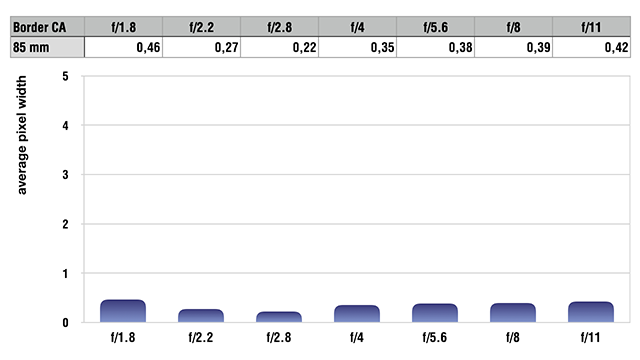

Chromatic aberrations (color shadows at harsh contrast transitions) are very well controlled, with very low values in the range of 0.22 to 0.46 pixels at the image borders.
