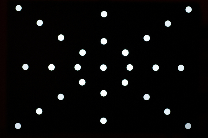

One of the main reasons to use a fast prime over any kind of slower zoom is its ability to separate the main subject from the background. For such images, the quality of the background blur is of major importance.
The Nikkor delivers very smooth and pleasing image blur in these kinds of shots.
Out-of-focus highlights are evenly filled with virtually no outlining. Thanks to the 9 rounded aperture blades, highlights retain their circular shape even when the lens is stopped down.
The shape of the highlights deteriorates a bit towards the image borders due to mechanical vignetting at large apertures. However, stopping down solves that issue.
