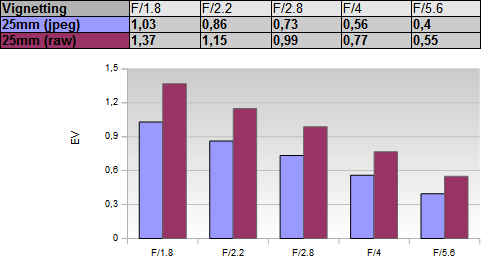

The lens shows only a fairly high degree of vignetting (1EV/f-stops) at fully open aperture. Stopping down reduces the light falloff but traces remain even at f/5.6. The uncorrected RAW figures are slightly worse but this may simply relate to a different tonal curve compared to JPEGs generated by the camera.
