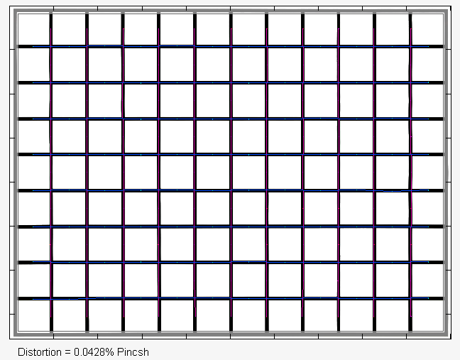

The image distortions are auto-corrected in the Micro-Four-Thirds system either directly by the camera (JPEGs) or by most RAW-converters. The "exposed" distortion is therefore moderate especially for a standard kit lens. It ranges from a moderate (~2.1%) barrel distortion at 12mm to negligible(~0.05%) pincushion distortion at 32mm. While you may spot the barrel distortion at times (e.g. during architecture photography), this is usually nothing to worry about.
However, when looking behind the scenes (e.g. via RawTherapee) the non-corrected raw images reveal a different situation with an extreme (~6.3%) barrel distortion at 12mm (on the positive side this is still less than for the Lumix G X 14-42mm f/3.5-5.6 PZ).
If you move your mouse cursor over the image you can switch to the corresponding non-corrected results.
