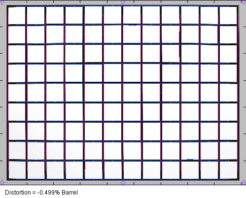

Technically distortion is a bit of a weak point of MFT lenses because the system relies on an auto-correction and as such minimizing the issue isn't really a design priority. You may argue, of course, that this is not relevant from a user perspective because all the applied corrections are done "under the hood". This is also something that we can confirm - standard JPEGs or conventionally converted RAW files don't show a significant amount of distortion. At 12mm, there is only a slight degree of barrel distortion (~0.5%) and it's negligible beyond.
Nevertheless, it is still interesting to look behind the scenes by using an "unsupported" RAW converter. This reveals a native barrel distortion level of disappointing 8.5% at 12mm, which is on the extreme side. However, at 25mm it isn't overly relevant while the 1% of pincushion distortion at 40mm is a moderate issue.
