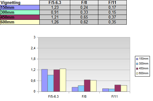

There's a moderate degree of vignetting at maximum aperture throughout the range with a peak of about 1.2EV (f-stops). While this is visible for sure, it is not extreme by full format standards. Stopping down to f/8 resolves most of the issue and it's negligible beyond.
