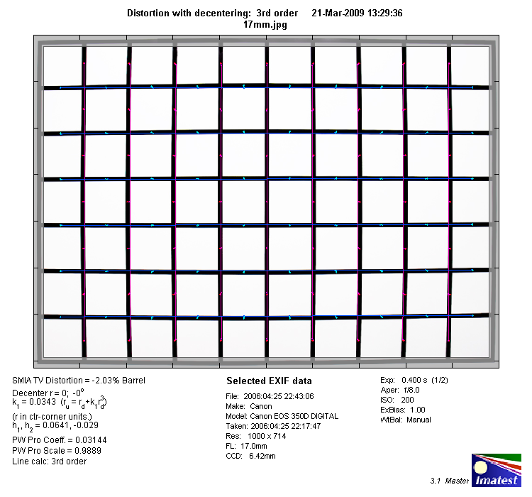

The EF-S 17-55mm f/2.8 USM IS exhibited average distortion figures for a lens in this class. There's a relatively pronounced degree of barrel distortion (2%) at 17mm. This evens out very shortly beyond and starting from around 24mm you can expect mild pincushion distortion which increases continuously towards the long end of the zoom range (1.15%).
17mm 24mm 35mm 55mm
The chart above has a real-world size of about 120x80cm (taken from the initial review).
