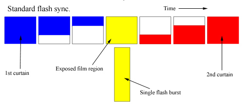

In std. flash sync. mode the flash fires as soon as the whole film frame is fully exposed to the incoming light (see picture below). This time period is obviously limited towards higher shutter speeds dependent on the speed of the shutter/curtain mechanism. This max. flash sync. speed is given in the specification of a camera. The current fastest max. sync. speed is 1/500sec is close to the flash duration of strong flashlights (around ~1/500sec for a full burst). Consumer grade SLRs can normally sync. up to 1/180sec.

Many cameras offer the possibility to synchronize either on the 1st or 2nd curtain. With 1st curtain sync. the flash is fired as soon as the 1st curtain is in upward position while with 2nd curtain sync. the flash is fired just before the 2nd curtain moves upwards. Obviously this means that the natural (ambient) light of a scene exposes the films either behind or before the flash burst. If you shoot e.g. a fast moving object with 2nd curtain sync. you'll get a blurred moving effect which will end in the (flash-) exposed object. With 1st curtain sync. it'll be the other way round.
