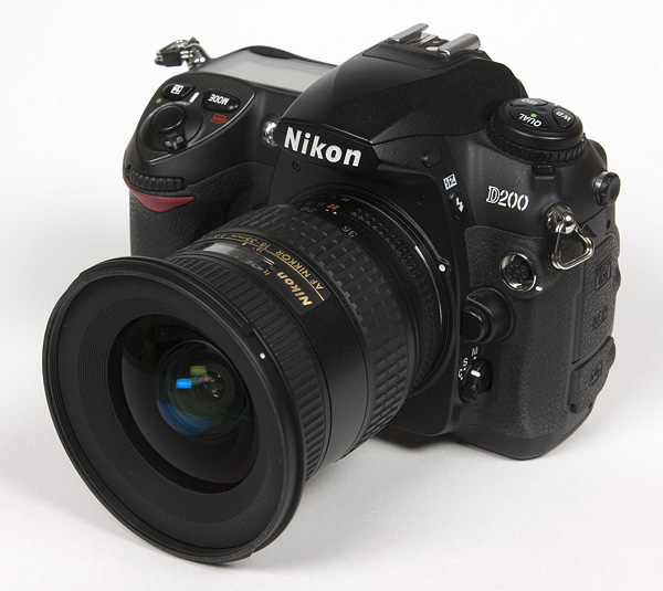

The Nikkor AF 18-35mm f/3.5-4.5D ED was released in 2000 and at the time it was the first consumer grade ultra-wide angle zoom lens (full format) by Nikon representing an affordable alternative to the professional grade AF-S 17-35mm f/2.8D IF-ED. Its field-of-view within the APS-C DSLR scope is equivalent to 27-53mm so it can be regarded as some sort of standard zoom here although the 1.9x zoom ratio doesn't really make it an overly attractive alternative to the slightly cheaper Nikkor AF-S 18-70mm f/3.5-4.5 DX (APS-C only) for instance.

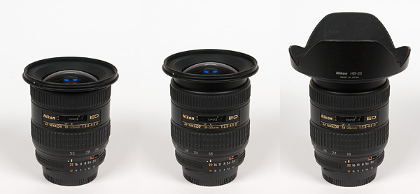

The build quality of the lens is fine although it doesn't leave its consumer grade origins here. Both the zoom and focus ring operate smooth without being damped though. As you can see in the product image below the lens extends a bit when zooming towards the wide-end of the range.
It isn't mentioned in the lens name but it features an IF (internal focusing) design so the front element does not rotate and the physical size remains constant during focus operations (not during zooming). Unfortunately the 18-35mm ED does not yet take advantage of a silent-wave AF drive - it does still rely on the slotted drive screw operated by the camera although speed-wise the AF leaves nothing to be desired (reads: the AF is very fast).
